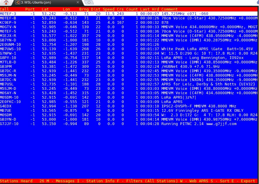

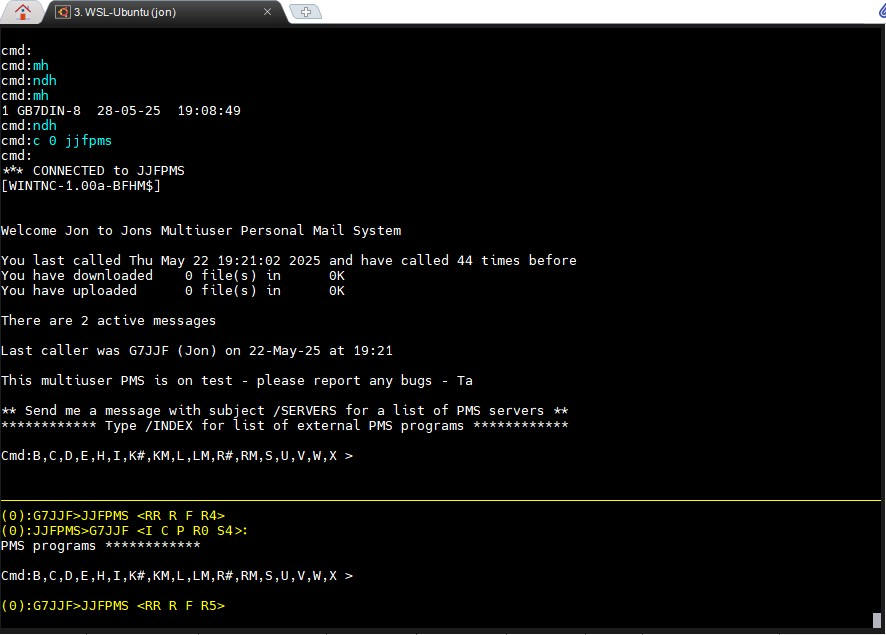

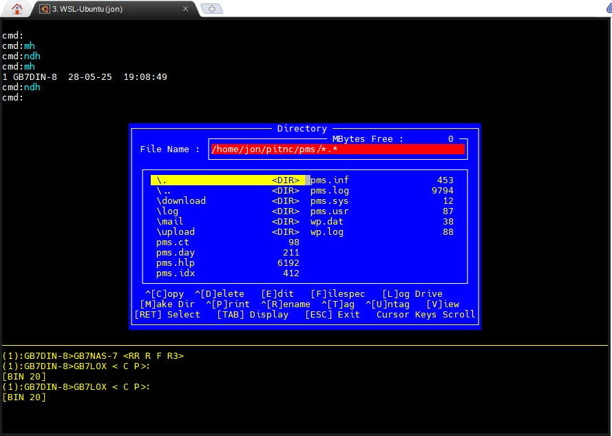

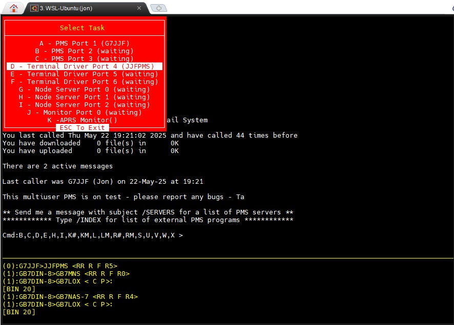

I am currently looking at porting the Windows WINTNC code to Linux and this is progressing very well. I have all the core feature of WINTNC working on Linux and the code is running on Raspberry Pi's as well as desktop distributions such as Ubuntu and Mint. The interface uses ncurses so is text only.
It uses the same comms interfaces as the Windows version, eg KISS mode TNC's (including the BTech UV-Pro and VGC NR-V76 KISS radios via Bluetooth), AGW etc and includes all the same PMS, NODE, APRS features etc.
The porting isn't quite finished yet but is working well enough at the moment to be very useable. See screen shots at the bottom of this page.

F12 - Show task window
