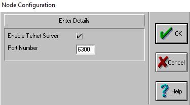

To enable the node, you need to go to the Node Configuration option of the Alt-S configuration menu item :
Click the tick box to enable the server and enter the desired port number.
You will also need to allow this port through your computers firewall (if enabled) and also setup port forwarding through your router to the computer running WINTNC. Instructions for this are beyond the scope of these notes as this differs between computer setups.

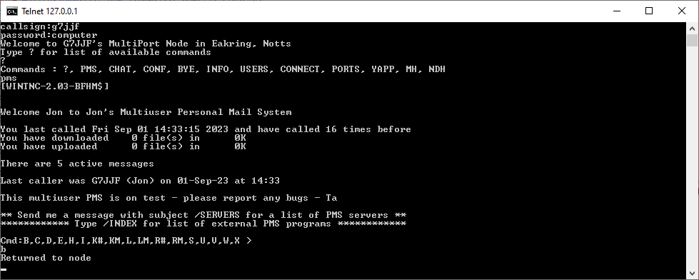

Once this is all configured and WINTNC is running, a remote user can use a telnet client (such as WINTNC itself or the Windows telnet program) to connect to your node or you can locally connect using the 127.0.0.1 loopback address :

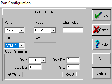

You can now communicate with a TNC which is not in KISS mode. This bypasses the inbuilt KISS mode AX25 driver and allows you to use the TNC as you would with any other terminal driver program.
You configure this by adding a RAW port through the Port configuration dialog box :
Specify the same parameters as you would for a normal KISS mode TNC.

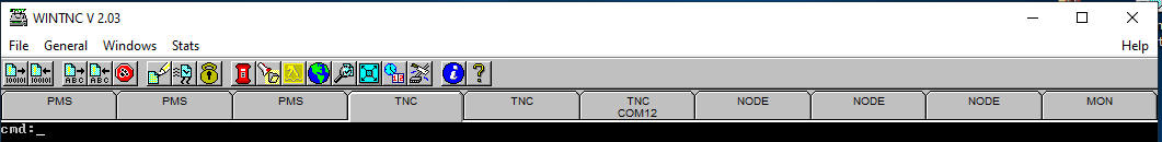

When you then run WINTNC, the last TNC tab is then dedicated to communicating with the attached TNC over the specified serial port :
You can then click on the COM12 tab and talk to your attached TNC. You can add as many RAW TNC's as you need, each one using the next available TNC tab.
